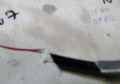

You guys don't know the trick yet? Here is the detail. The plug connector on Cmos battery of CF-M34 has 3pin. It only use pin 1 & pin 3. Pin 2 is empty. When you have already a Cmos battery from other unit with 2pin plug. No need to cut it out or splice if it is long enough.
Just pull the cable from the plug by lifting up the plastic lock on it and then hook it to the othe same technique to the other. Here is the picture for you to have an idea what I am talking about. But be very careful not to damage the the plastic. Its pretty easy.
Sorry! my cellphone camera, sucks! Lol
- IMG_0378.JPG (47.4 KiB) Viewed 21283 times
