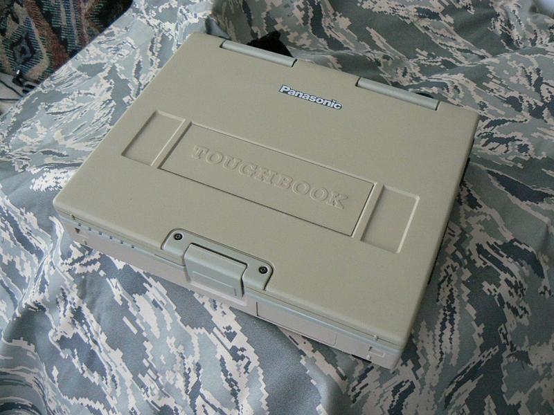

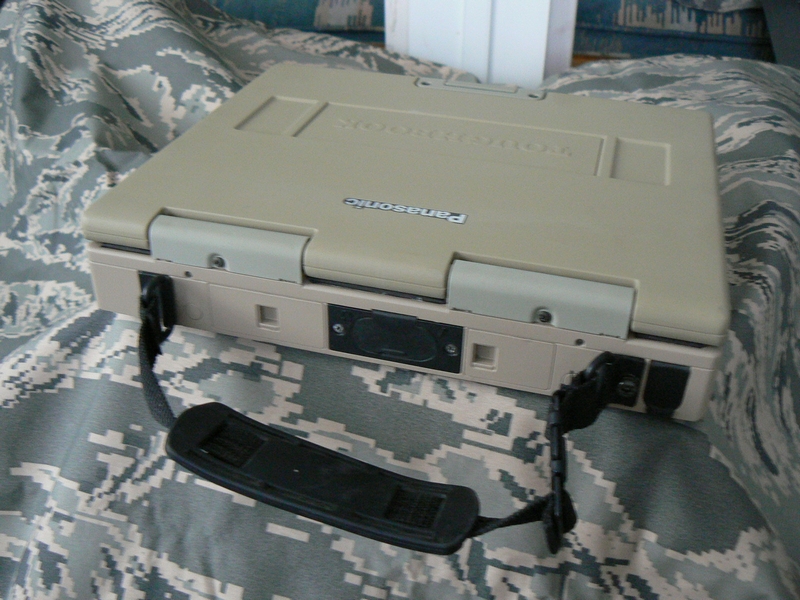

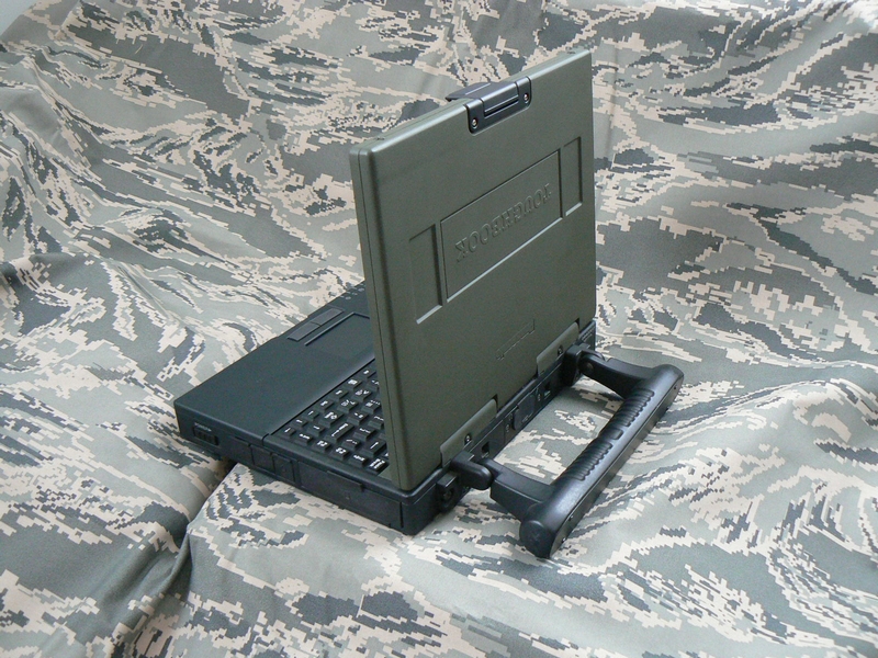

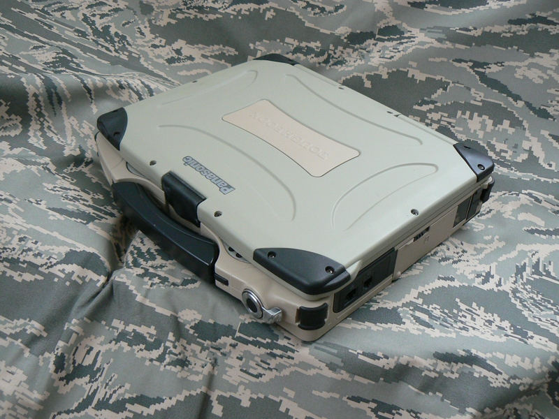

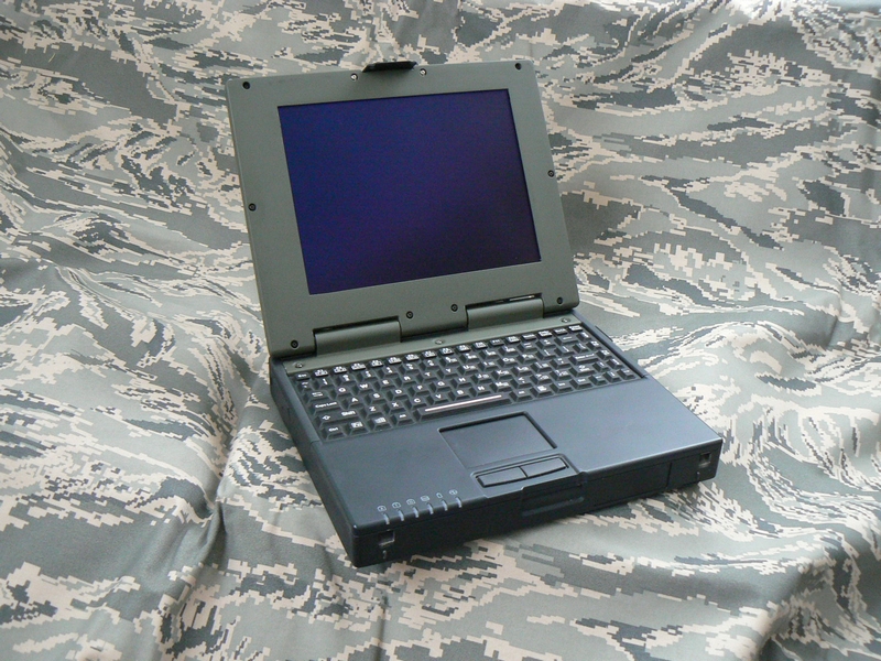

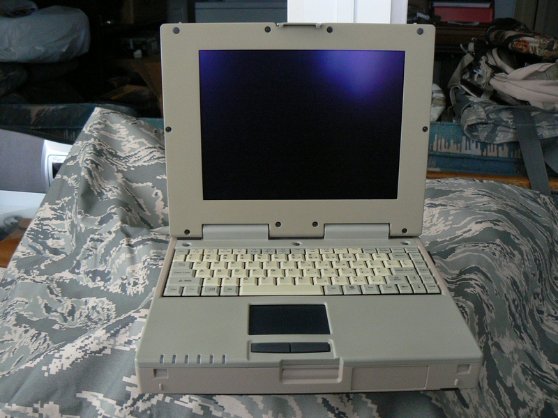

Here are two CF-M34's I did in OD green and desert colors (plus a CF-28 I also did) to get an idea of what you can do with some time and rattle cans.

Very nice! I have plans to do a little work like this to a few of mine as well along with a few other cosmetic mods.
