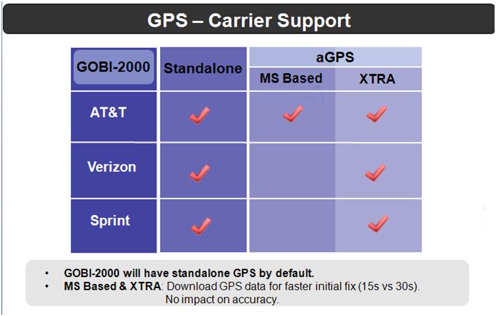

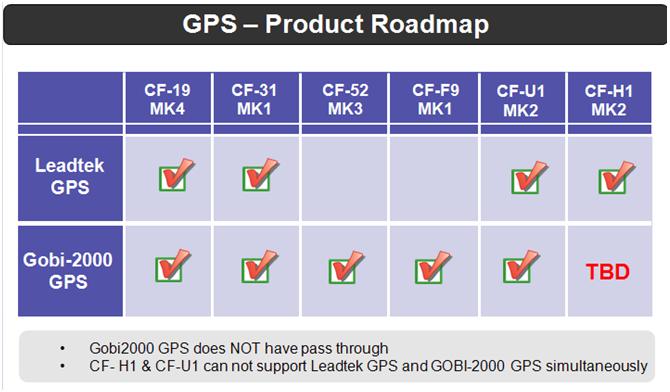

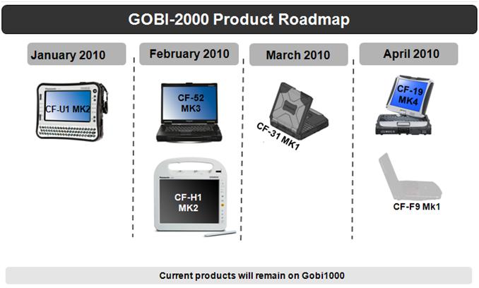

It appears that there is going to be two GPS options. A stand alone embedded GPS reciever, and GPS on the GOBI 2000 card for the fully rugged line. But now that the GOBI card will have GPS models like the 52 and new F9 that previously did not offer embedded GPS will now be able to offer GPS capabilities.

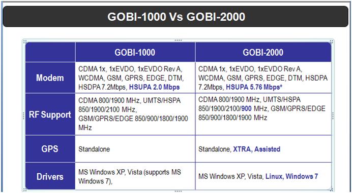

UPDATE: GOBI 1000 users will be seeing a firmware update coming for HSUPA. Once ATT has updated thier network, they will allow HSUPA 5.6mps and the firmware update will allow the GOBI 1000 card to take advantage of this new speed. This feature will ship standard on GOBI 2000 modems.

... sucks for us on 21mbps HSPA networks as the new Gobi doesn't support those speeds. Yes, theoretical top speeds but I've hit 10mbps before on Telus (Canada) with a Sierra Wireless 306.

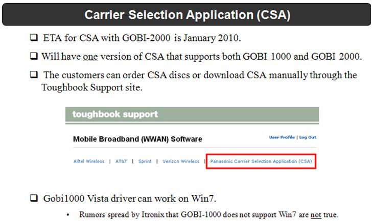

Any one know that if there is new CSA and VZA which support the GOBI2000 in the CF-30?
I've try to install it in my CF-30mk2 with no luck ! any suggestion is welcome.

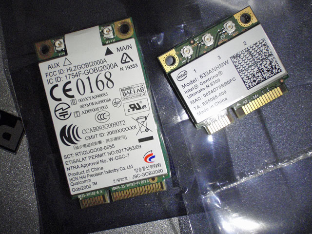

- gobi2ks.jpg (127.64 KiB) Viewed 25293 times

canuckcam wrote:... sucks for us on 21mbps HSPA networks as the new Gobi doesn't support those speeds. Yes, theoretical top speeds but I've hit 10mbps before on Telus (Canada) with a Sierra Wireless 306.
Its not that GOBI does not support that speed, because it does. ATT had Qualcomm limit the speed. THey are just now allowing us the open the HSUPA speed which will be in the upgrade.
