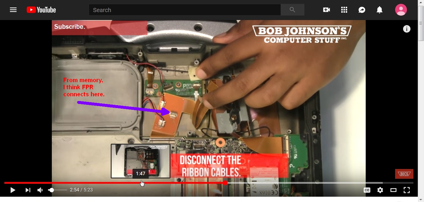

Rob (or anyone) - Help!
I've just received a CF-31 fingerprint module and tried to install it.
Your photos appear to be the only ones in existence showing the fingerprint cable to the internal connector, centre front - but there is just an empty space there in my machine, no connector.
Any clues?
Any clues?

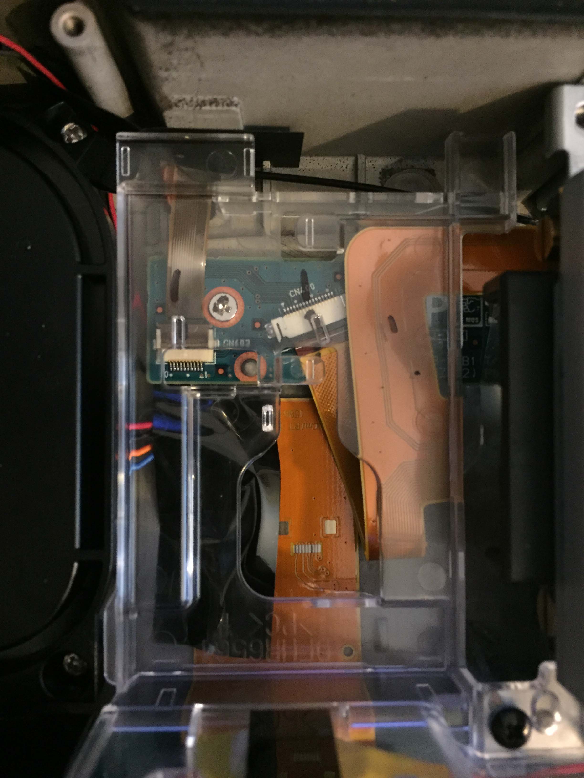

post a photo of the missing connector location please
Re: CF-31 - Anyone have a Mk5 service manual - or any other useful info?
Photo attached:
Edit - searching for the part number from the manual you provided, I found this:
https://ruggeddepot.com/cf-wfp311r-retr ... sonic-oem/
No other place seems to distinguish between the Mk5 and earlier versions - and Mk5's are available with a fingerprint reader. It must be a different kit with a different interface, or they provide a replacement for the bid multifunction cable as well.
- CF-31, view of area around the underside of the touchpad
- CF-31.jpg (370.57 KiB) Viewed 25028 times
Lemme look at some parts units when I get home.

Here is a video capture.
You do have an issue.
Cable looks different also.
An older cable will probably not work.
Might need to buy the proper mk5 cable from Heartland.
If it was mine, I would add the needed socket, but I have a hot air station and all of the
needed equipment to attempt it. Still tricky soldering a flexible cable. Low temp paste solder and hot air are a must.
Can you read any numbers off that cable?
