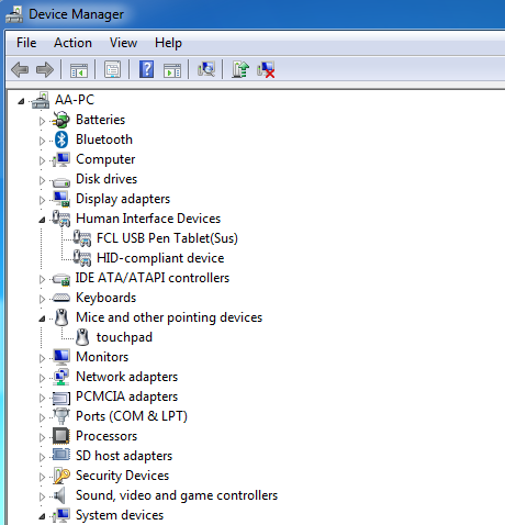

Re: CF-31-A Touchpad requires excess pressure~ Suggestion?
Are you seeing THIS in device manager?
- mouse.PNG (47.76 KiB) Viewed 20530 times
Yes Sir~
Mice & HID look exactly the same.......
The Thermal issue in trouble shooting is gone ...no more exclamation marks
But alas both the touch pad and touch screen aren't right
