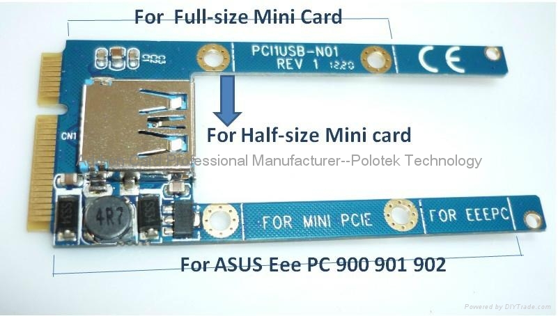

I just purchased a little Fujitsu Q550 atom slate pc, and it has an empty MPCIE slot inside (for a wwan card). I want to know if I can use it for GPS as follows....
Shawn had pointed me to a ublox7 usb mini gps dongle, and I ended up not using it, since I already had a ublox 6 and ttl converter. I also wasn't sure if it would work with s&t since it outputs usb from the ublox chip directly and not uart?
So, will thisVK-172 gps work with Streets and Trips?
Can I use that gps wired directly into a MPCIE slot's usb pins? or would I have to use an adapter as pictured?
