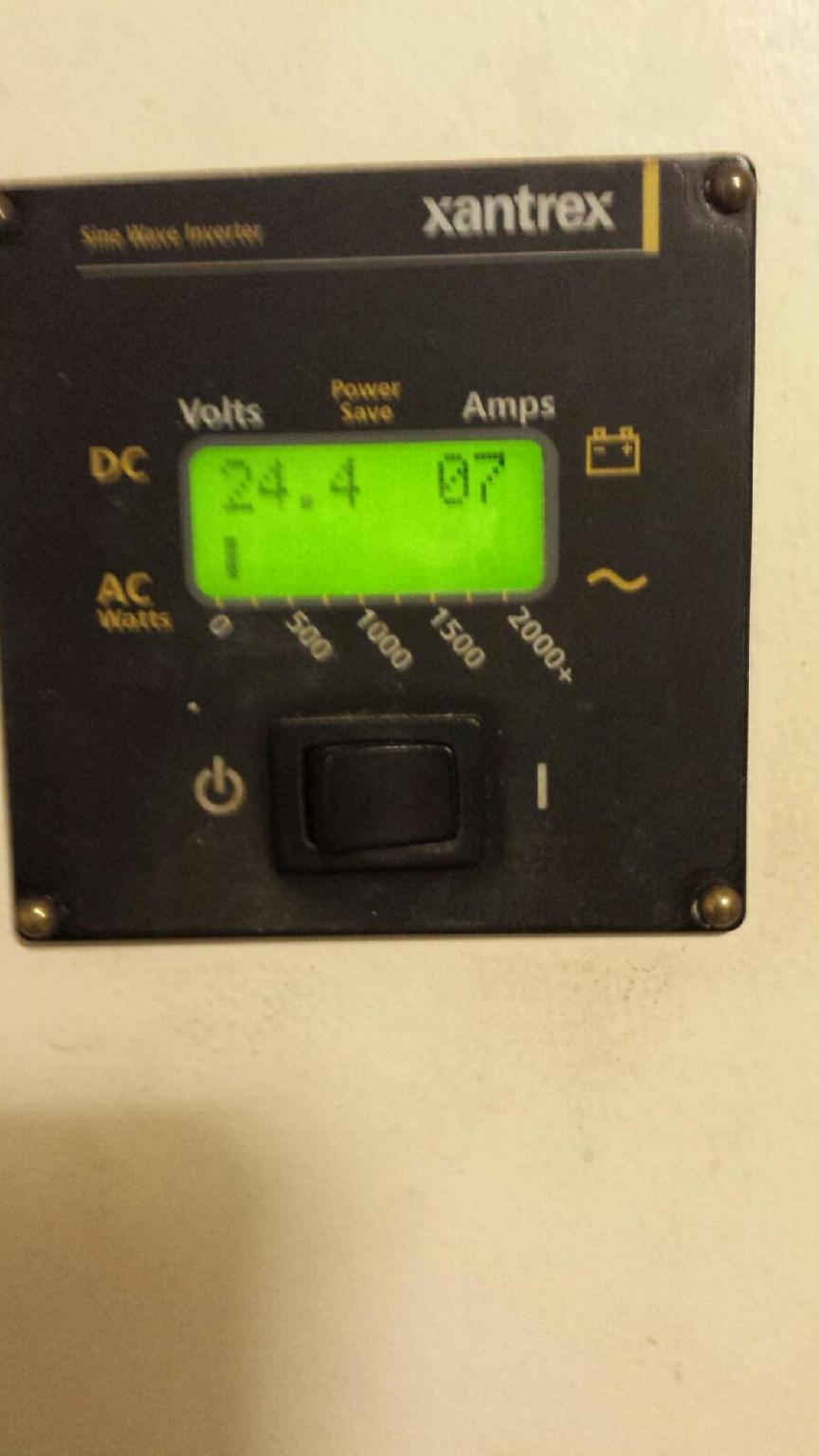

My meter/on-off has been tweaked a bit, the face-plate is next to the toilet where I could possibly be standing sometime during the day. Not trying to be crude but it's the closest place in the house to the power/pump house.
BUT, reading aboot the wind unit...
1. Power comes out three phase AC. (NOT DC) (therefore dangerous as zark)...
2. Line loss for AC negligible....which is a good thing. Compare 10/3 w/ 0 size wire.
Picture inbound of face-plate. Typical reading for dark outside and a bunch of battery chargers running.
More later if you need it.
