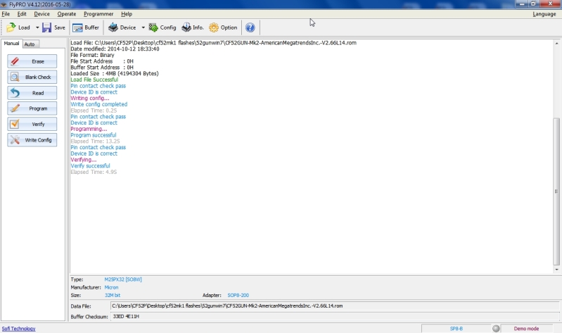

I managed to flash a CF52GUN BIOS chip with a software backup ROM file using my programmer. This is the first time I have had any success doing that.
The file was one Springfield sent me quite a while ago. 4,096kb in size. I think he used universal bios backup toolkit. I need to find out for sure. The rom file was named CF52GUN-Mk2-AmericanMegatrendsInc.-V2.66L14.rom It is a Win7 BIOS so I will check that next.
Not sure what I did different. I am posting a screen grab of the programmer log.
One thing I know I did was pull ALL drives before rebooting. Clicking the write config button was new also. I can't get to the CMOS battery so I could not reset it. The BIOS hours stayed the same. The model number changed though. I do have another BIOS chip that is flashed with the original BIOS so later on I will compare them more closely.
The hard drive does not have an OS on it.
FLASH CF52gun WITH PROGRAMMER.jpg (85.44 KiB) Viewed 18608 times
