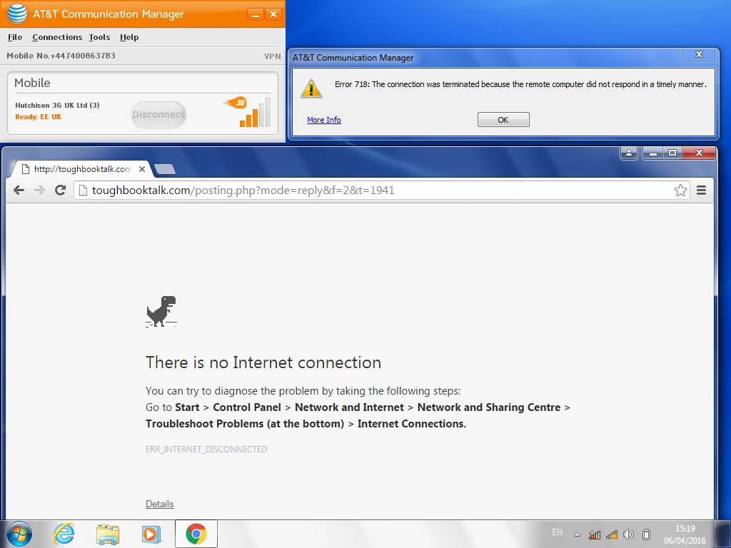

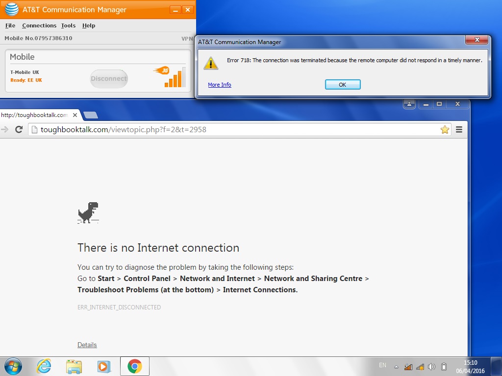

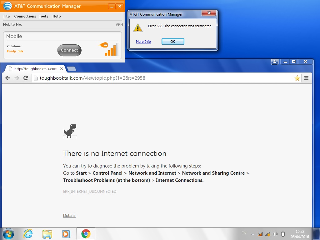

Hi Guys
Looking to finally solve this problem for UK/European users so future toughbook owners can benefit.
As some know I have a CF-30 MK 3 with a gobi 1000 card installed as standard however im am still struggling to get it to work in the UK and have tried with the AT&T carrier, so i have sourced 3 out of the 4 networks sim cards that are available in UK and none work properly, the EE sim is (Orange,T mobile) worked for about 3 mins and then dropped out, The 3uk network card done the same and the Vodafone wouldn't connect at all? and if you look at my attached pictures they include the error messages. didn't try the 4th UK network o2 as i couldn't source a sim in time.
I am at a stage now on thinking its locked?? I have under the very kind direction of Shawn and others loaded on the recent panasonic CSA and installed the AT&T carrier software and the results are above, I also tried the Sprint and the Verizon software but they just kept crashing my laptop.
So please someone can anybody help in this? is there anybody even in the UK that has this running can help or is my card locked have noticed on e-bay Chinese ones marked as unlocked.. how do you unlock them?
- 3 UK sim.jpg (133.12 KiB) Viewed 19479 times
- Vodafone UK sim.jpg (123.32 KiB) Viewed 19479 times
- EE UK sim.jpg (129.8 KiB) Viewed 19479 times

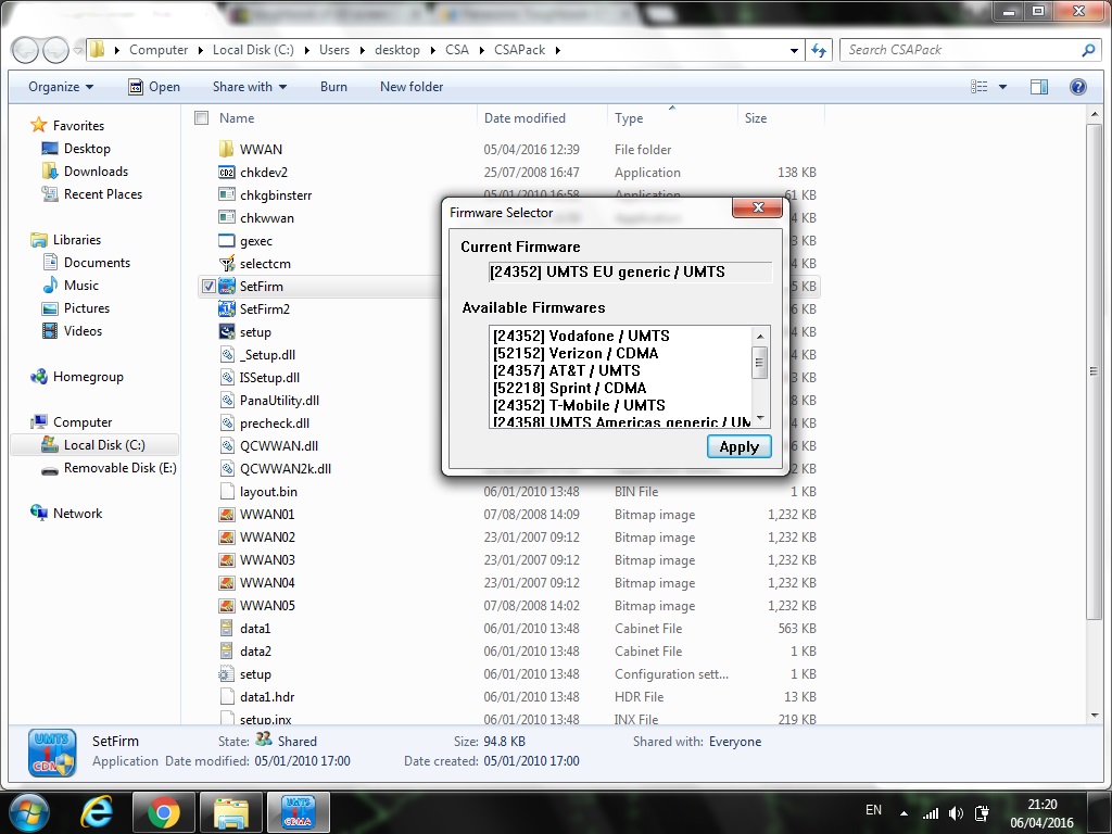

Re: Toughbook CF-30 Gobi 1000 for use in UK networks
Hang on think ive got it went into the csa pack and found a a file called set firm look at this
- set firm in csa pack.jpg (205.08 KiB) Viewed 19466 times
