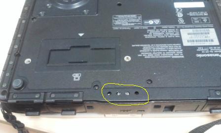

Am I missing a cover from underneath, everything seems to be so well sealed yet I have 4 open holes underneath near the port replicator port.

It's not just you, everyone with a 18 has that, lol. The rubber seal for the bottom goes around that so it still seals the motherboard off.
