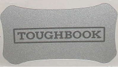

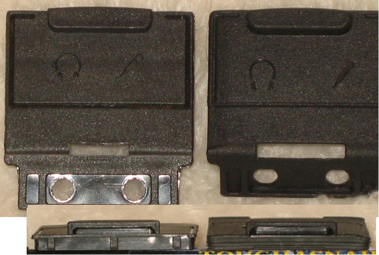

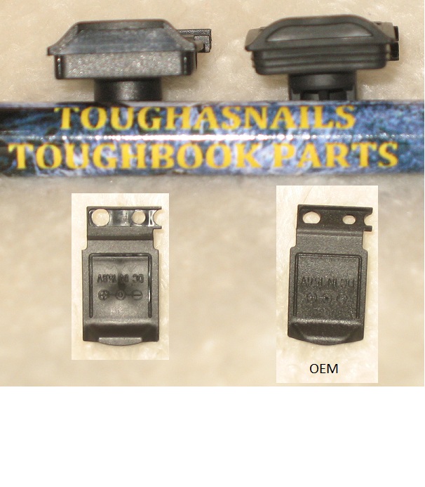

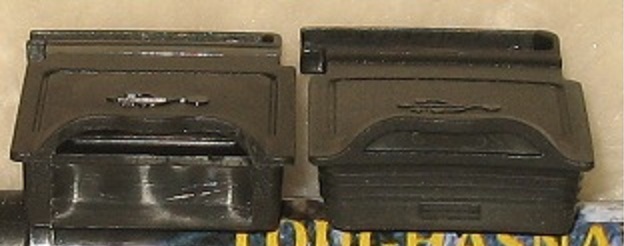

Ok here are the pictures of the china port covers (left side) and the OEM covers (right) The china covers are made out of hard plastic and do not flex as good . i can not see them lasting as long as the OEM ones. On the CF-30 ac/dc China cover it is dented in not flat as you can see in the picture (1) . As you can see in the next 2 pictures the sides are flat and does not have any rubber ridges to keep the dust and water out :eek: . The last port cover picture you can see a line going across it...they all seam to have this. The CF-19/30 Toughbook badge looks good...it just does not have the raised letters which is fine with me...these make a great car/truck window or bumper sticker :D .
I for one like saving money but this is not the way to do it. I take my Toughbooks every where and I like not having to worry that water or snow will get to it . Picture don't lie...you be the judge.

CRAP! Those look like... CRAP! lol
They need to make a few improvments before I'd use that in one of my customers toughbooks!

I finally received the 3 aftermarket port covers a couple of weeks ago, that I ordered from a HK seller on ebay (http://www.ebay.com/itm/261068304385?ss ... 1439.l2649
The DC and USB covers are exactly like those in the pictures above, same plastic, no ridges on the sides, same concave dent on the DC one.
I don't have OEM DC/USB covers to compare, but I can say this:
* first, when replacing the metal bracket under the bottom, one of the screw holes on the USB cover had a smaller diameter, so it would not go in all the way, until I enlarged it a bit.
* the DC cover has to be pushed hard to stay (barely) closed, and even then, it doesn't stay flush. after a short while, it comes open by itself.
* the USB cover seems ok though, remains closed and flush, for now

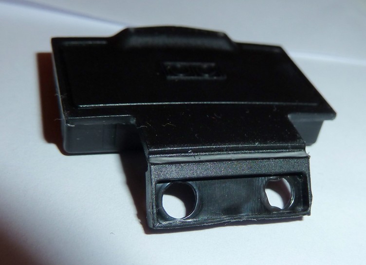

* the Serial cover: as you can see from the image, the thin part where it bends over the edge, was a real letdown. The plastic turned white-ish after the first time I bent it. It won't take too many open/close cycles before it breaks.
I didn't even bother to mount it (the OEM serial one I have is worn, but still makes a good seal and stays in place).
Plastic will never make a tight seal with metal, rubber is the way to go.
I should have bought the OEM ones from the start, but now I really know why ;).
