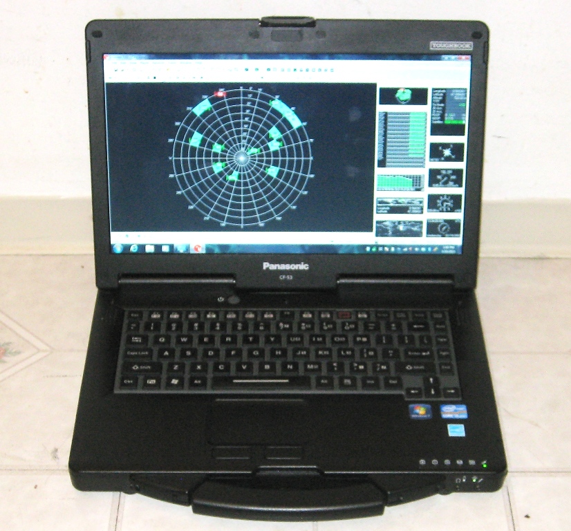

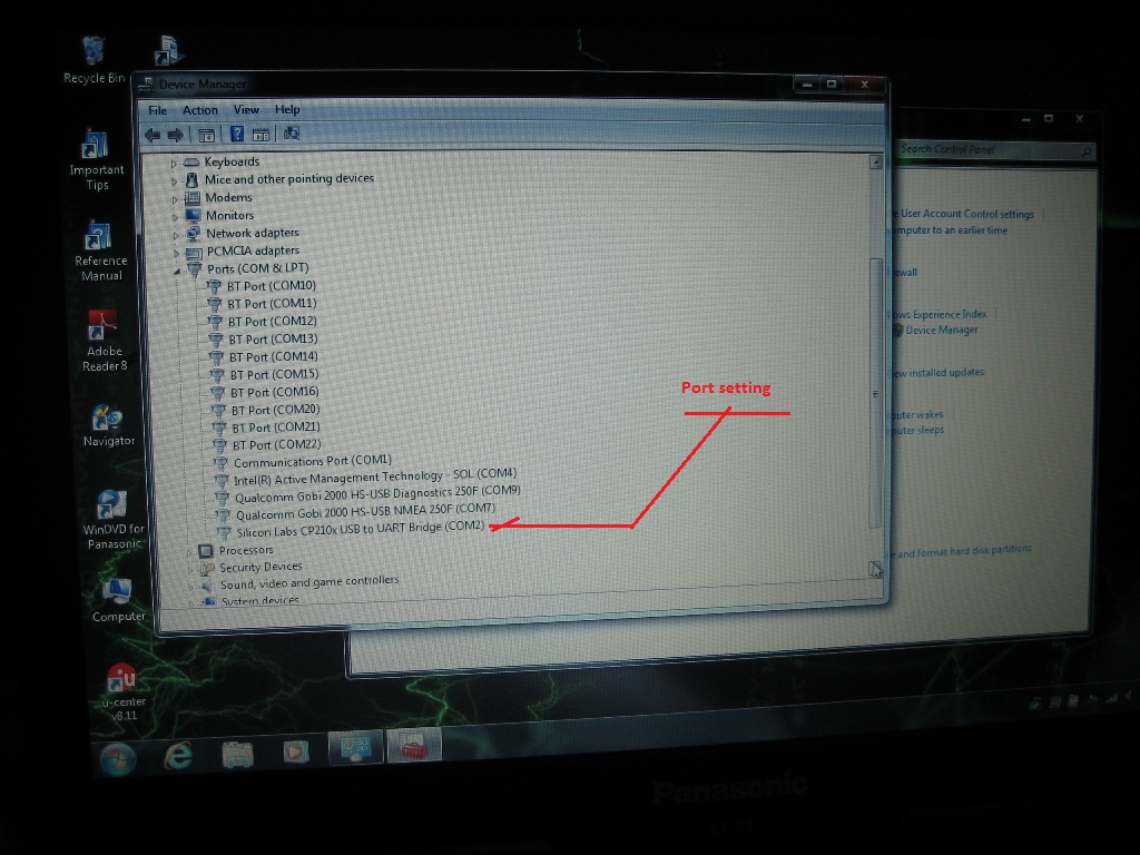

Ok! All was done! according to a plan but the PITA is when the "serial ball mouse" shaw up. Its tricky to disable it on the device manager but I managed to dis. it finally. Here is the final.

So, instead of prolific driver( USB to TTL ), its now Silicon lab driver( USB to UART ) see picture.
