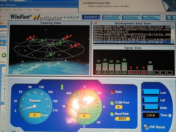

#15 Post by toughasnails »
All the drivers installed and GPS working...I think . Since I know nothing about GPS what is winfast telling me...found 6 sats

#18 Post by teo »
toughasnails wrote:All the drivers installed and GPS working...I think . Since I know nothing about GPS what is winfast telling me...found 6 sats
Blair! Its perfect! you have a working Gps at com 4. Now! you only need is a compatible software for navigation like sreet & trips.

#19 Post by ADOR »
You might want to edit the picture of your gps working, it is showing your longitude and latitude.
Re: GoBook lll 260+
#20 Post by toughasnails »
ADOR wrote:You might want to edit the picture of your gps working, it is showing your longitude and latitude.
:pat: :blowaway: Thats what happens when you pull a all nighter... Can't believe I did that :doh:
