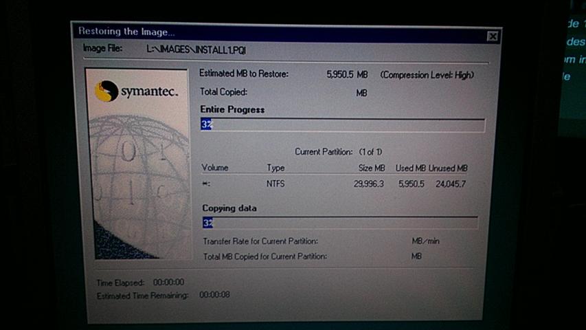

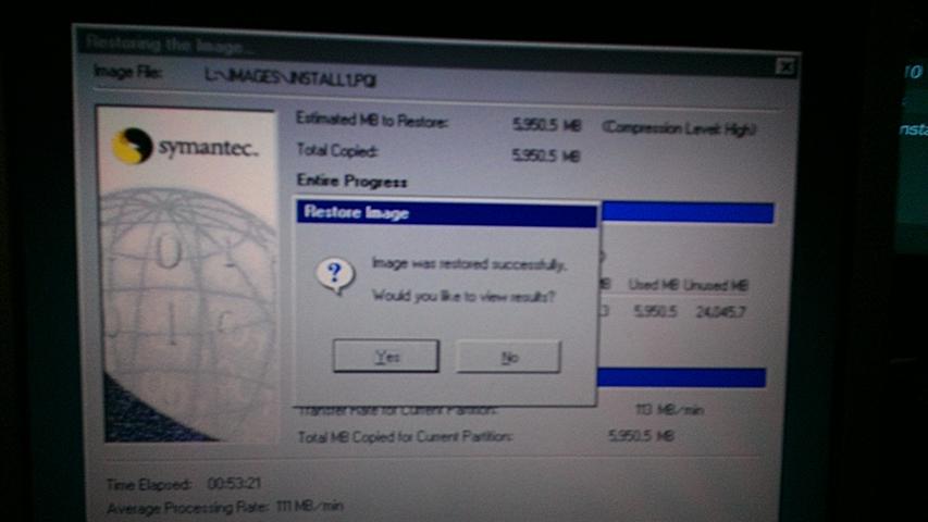

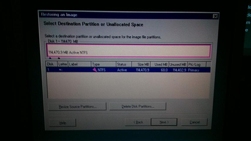

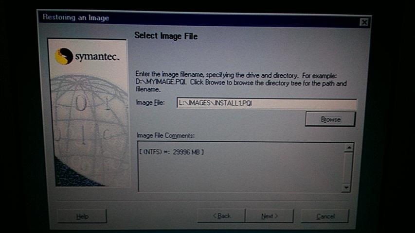

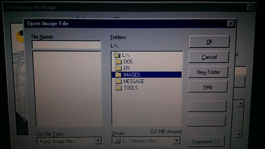

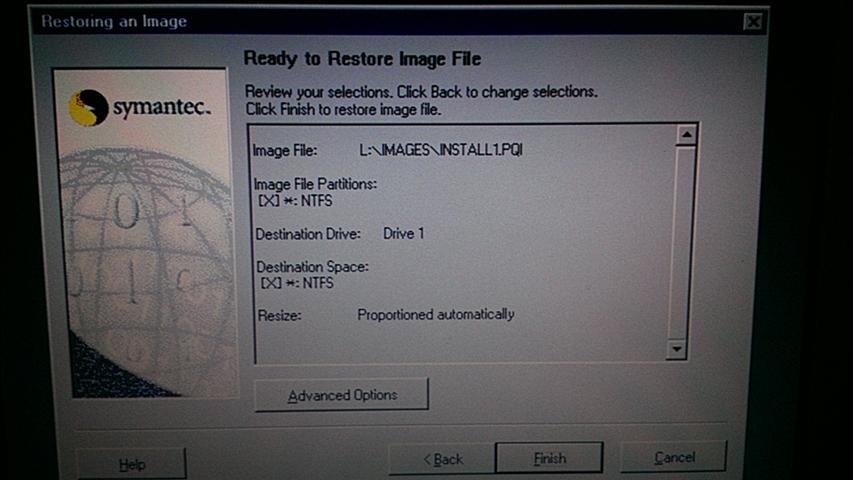

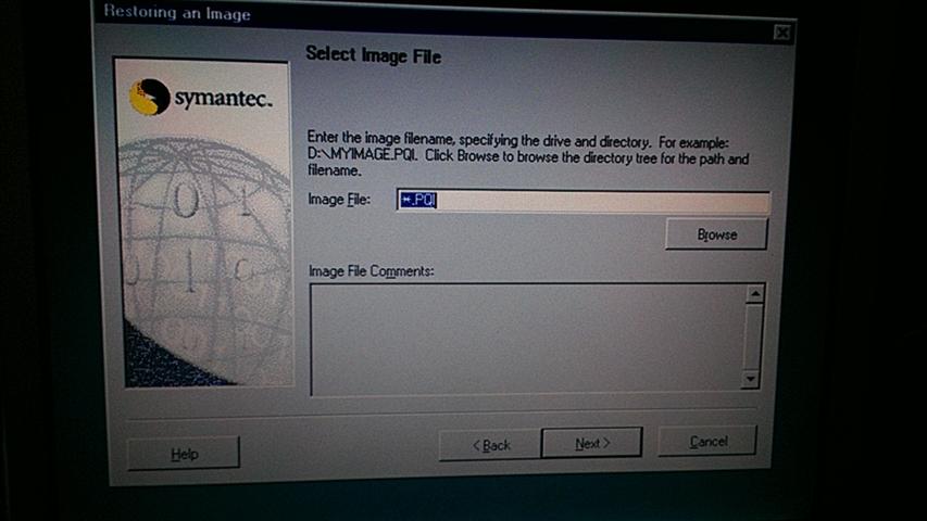

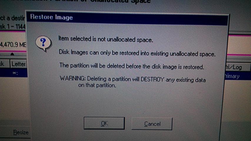

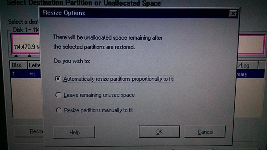

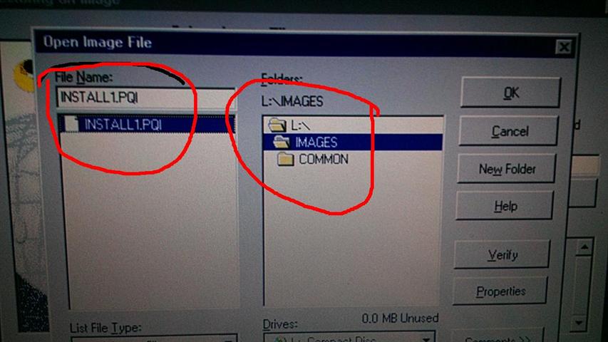

I could not get this command work. What did work was to press Ctrl-C and keep pressing it until you are asked if you want to stop the batch file. Answer yes, and you will be at a DOS command prompt. Switch to the L drive, as this is where your dvd drive was mounted. Then type pqimgctr.exe and navigate with the tab and enter keys. Like these photos
J (Small).JPG (46.46 KiB) Viewed 23641 times
I (Small).JPG (55.82 KiB) Viewed 23641 times
H (Small).JPG (62.2 KiB) Viewed 23641 times
G (Small).JPG (67.35 KiB) Viewed 23641 times
F (Small).JPG (70.41 KiB) Viewed 23641 times
E (Small).JPG (45.84 KiB) Viewed 23641 times
D (Small).JPG (53.53 KiB) Viewed 23641 times
C (Small).JPG (67.3 KiB) Viewed 23641 times
B (Small).JPG (62.62 KiB) Viewed 23641 times
A (Small).JPG (55.28 KiB) Viewed 23641 times
