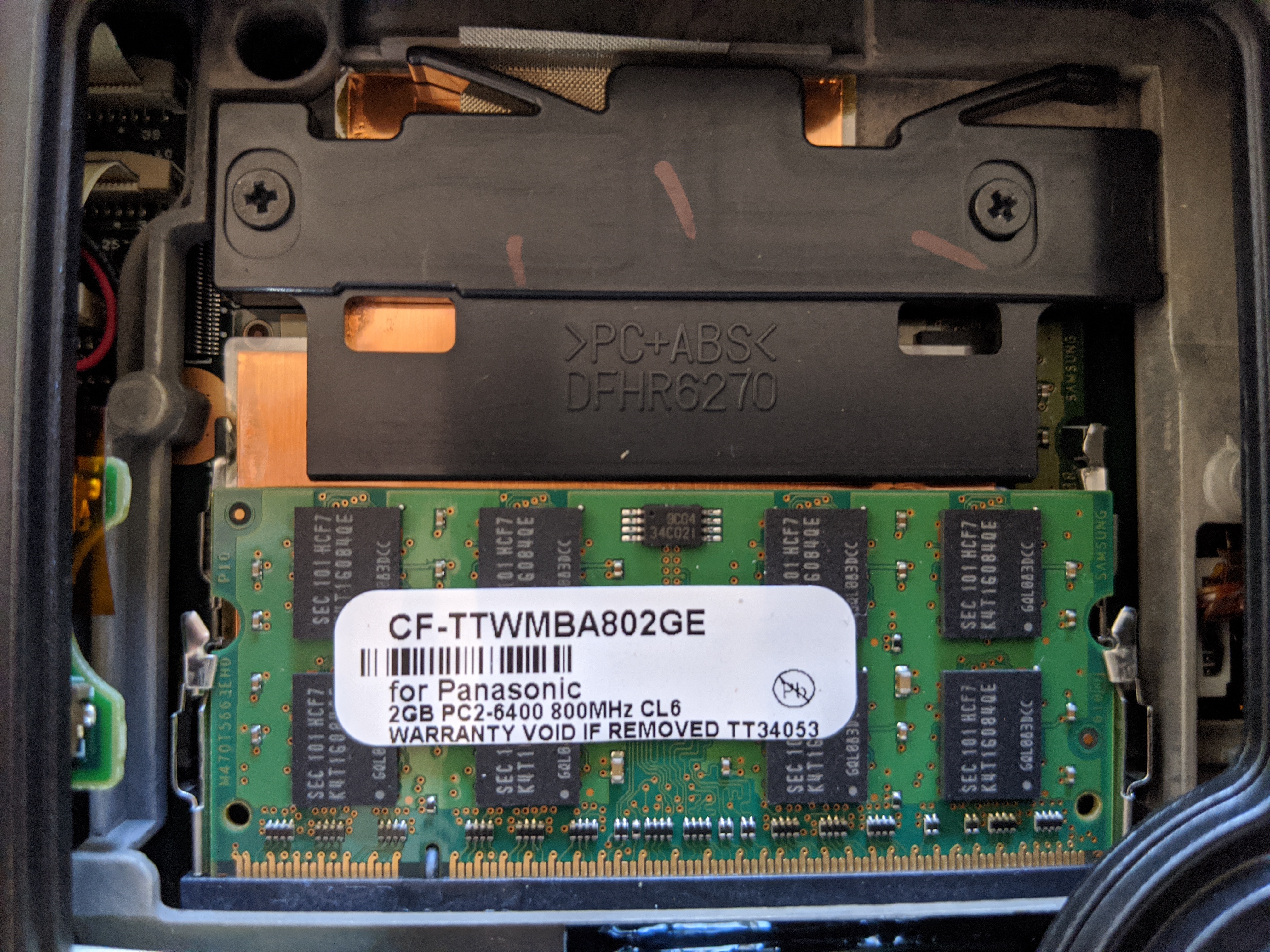

My 64-bit Mk2 CF-30 has 4GB of RAM installed (2x2GB PC2-6400 800MHz CL6 modules). I read somewhere that 64-bit systems could run with a maximum of 8GB RAM, so I'm thinking of swapping them out with 2x4GB PC2-6400 DDR2 800MHz modules.

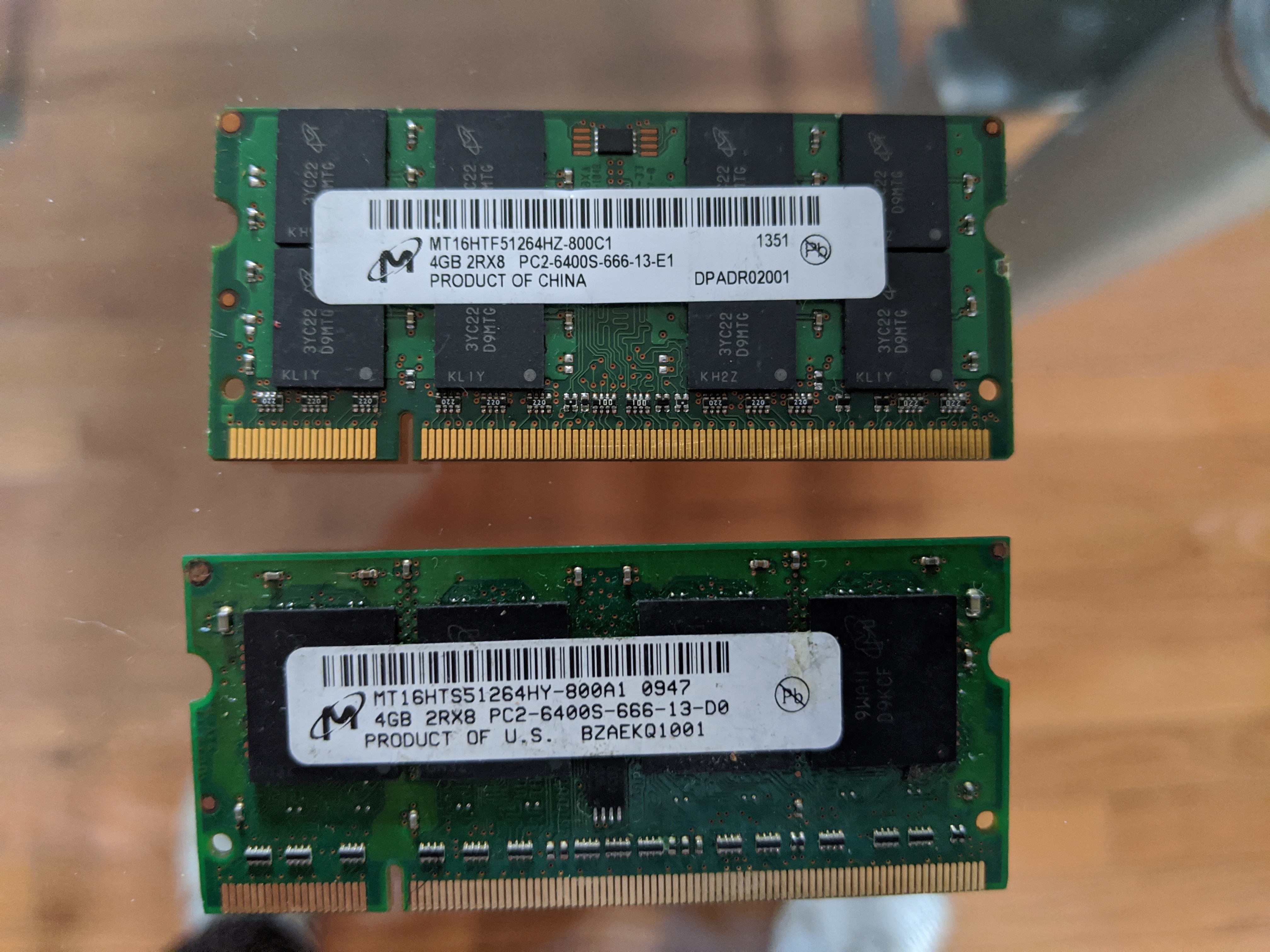

Well, I tried it with 6gb and 8gb and neither worked. In fact, I couldn't even get the screen to turn on. The hard drive light by the touchpad blinked twice and that was it. So I put the 2x 2gb chips back in. I guess 4gb is the best this model will do. :-(

What type ram are you using that works, what did you put in there that didn't work.
Re: CF-30 RAM upgrade
I have attached photos of the 2 x 2gb chips in the CF-30 now and the new 2 x 4gb ones I tried to install.
I think the problem may be that the current chips are listed at 800 MHz while the new one show 666. Also, one of the new chips appears to be high density (the one with 4 modules on the stick) while the other may be low density (8 modules).
Does this make sense?

- These are the new chips I tried to install.
- 4gb chips.jpg (4.38 MiB) Viewed 20380 times
- These are the current 2 x 2gb chips.
- 2gb chips.jpg (4.64 MiB) Viewed 20380 times

Have you tired each 4 gb chip by it's self yet? When I get a chance later today I am going to do some cross referencing.

Here is the offical thread from the 8gb of ram upgrade on a mark 2. He used the low density. Think most toughbook ram is low density double row.
http://forum.notebookreview.com/threads ... ry.752813/
Discussion about ram before it was installed
http://forum.notebookreview.com/threads ... k2.751942/
Thanks. I tried both 4gb chips together and each 4gb chip with one of the existing 2gb chips, but I don't think I tried just one of the 4gb chips. Although even if each one singly worked, it would still only be 4gb total RAM. I suppose if either of the new 4gb chips failed to work by itself, it might suggest a bad RAM stick.
