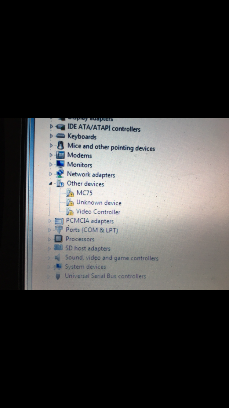

I have a cf18k with windows 7 on it I can't find the drivers for
3 of the devices, I could do with someone who would send me the links to
each of the drivers I have been looking for over a week reading and trying
to find them, I end up half the time going on sites that mess stuff up the
system restore is not working now because of this. I know windows 7 is not really meant for this but I have read it is possible by using driver from xp and vista etc, it's just that I am new to this and need some help and Direction thanks anyone who can help if you can help the missing drivers are
mc75
Video controller
Unknown device
Drivers help
Drivers help
- IMG_2335.PNG (879.07 KiB) Viewed 29824 times

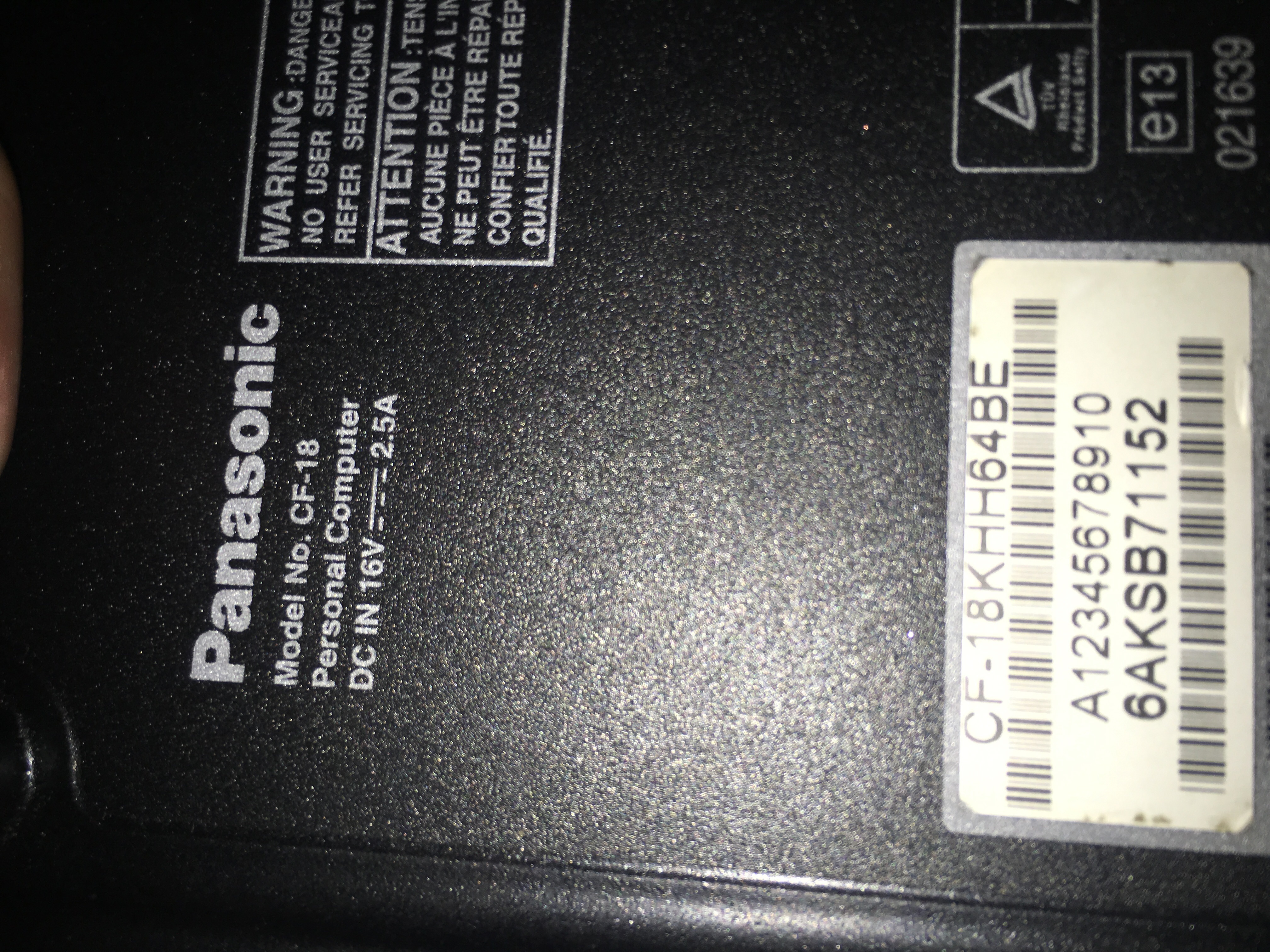

What is the full model number of the 18?
Re: Drivers help
CF-18KHH48BE: Mk4, Pentium M 753 - 1.2GHz (Centrino) 802.11a/b/g, 10.4 XGA High Bright Touchscreen, 60GB HDD - 512MB RAM - dual ant. connectors, Windows XP Pro SP2, non-NA market.

Re: Drivers help
Have you installed the Panasonic Hotkey, Misc and Common Drivers yet? Or any drivers at all? For the three listed drivers I listed got to a CF-19 that came from the factory with Windows 7 and install those. That will get those working. On the video and audio drivers windows 7 has there own generic drivers that will work, but you will have to look for the correct hardware drivers for it too work. I did have a version that will work for the video somewhere, but think I had to get a vista driver for the sound hardware. I don't have anymore CF-18's to try it on. Your video is a 915GMS so you will have to focus on that and see what driver will work or live with the standard windows one.
