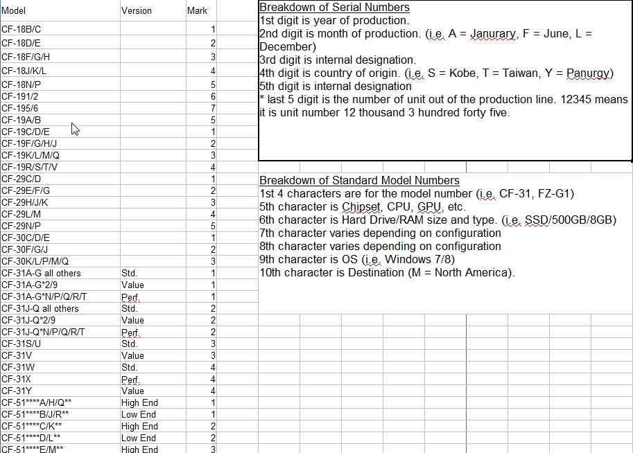

Posted: Sun Nov 13, 2016 8:29 am
by Shawn
Sorry that last one got screwed up in the conversion to a jpg.
This one is better
Toughbook model list corrected.jpg (278.42 KiB) Viewed 23730 times
Re: CF-31 Model letters within Marks
Posted: Sun Nov 13, 2016 10:15 am
by Geraout
Excellent - thankyou for your time.
