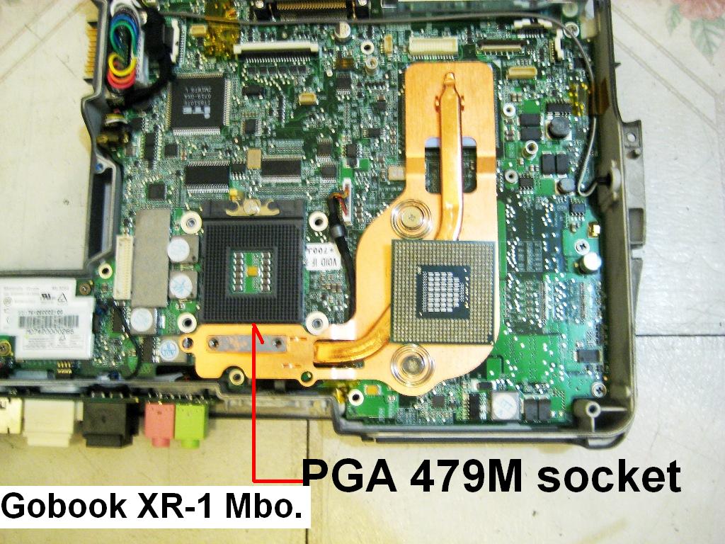

Ok! I've got a chance to work on these unit I have. I installed xp on one unit and Win 7 to the other one. Btw, I've got three unit and the last one is for thinkering. The two wrks flawlessly with said OS's.
The 3rd unit without the Hdd, caddy and battery is for you know, a test bed, Lol. Now! here is the good news it is socket type with PGA479M socket. It means it can upgraded like the cf-51. I say the best CPU for this is the T7600 but a bit pricey. I don't have spare right now but I will borrow the one on CF-51 with 2.0Ghz. Remember only with the 667Mhz fsb. Let see how it perform. Anyway, this also can be upgraded to 4gb RAM. If you guys remember my comment regarding the two cover door that is like not sealed but I found out that they are isolated from the inside. So, its still water resistant but my worry is the outside terminal may coz a short circuit eventhough it is isolated.
Now! here is the bad news. Its pain on the ass..to dismantle this unit. there are a ton of screws not mention a hidden screws but I am very careful and finally got it. My problem now is I am not taking an id to each in everyone of those screws. Maybe I will only use a common sense. In addition before you go ahead on dismantling this unit. First is to take off the thin plastic covering in front of keyboard(where the indicator lights) and the thin plastic covering on the palmrest. By doing that it will show you first hidden screws aproximately morethan ten. I haven't counted yet! Lol Almost each in every screws from the body will have to unscrews. On top of the after taking off rubber covering on each corner, it will show up another hidden screws. Be very carefull on the front two rubber protection. You must take out first the push release latch by pulling it a bit and again it will show up another screw on the rubber protection. To make story short or to give you an advice before doing it. Study carefully and make a plan. If necessary, right a tag on each screws to designated location.
Here is a snap shot of th mbo. after taking it off the cpu:

Great info Teo! Really appreciate your skill figuring out how to crack this nut. Looks like a lot of trouble, so don't think I will be upgrading my XR-1 any time soon LOL.

Teo. Do you have a picture of the XR-1 that shows the whole base off. I just want to make a note of ALL the screw holes. I just might pick up one of them.
