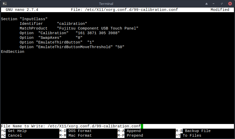

Run from terminal with one line.
I needed to use root terminal to run this. Possibly because it is on a LiveUSB. This was wrong, see next post.
xinput_calibrator --output-type xorg.conf.d --output-filename /etc/X11/xorg.conf.d/99-calibration.conf
Whatever text editor you use, append the two lines exactly as shown. Viola! right click!
Option "EmulateThirdButton"  "1"
Option "EmulateThirdButtonMoveThreshold" "50"
This is nano text editor...most any text editor will work.
