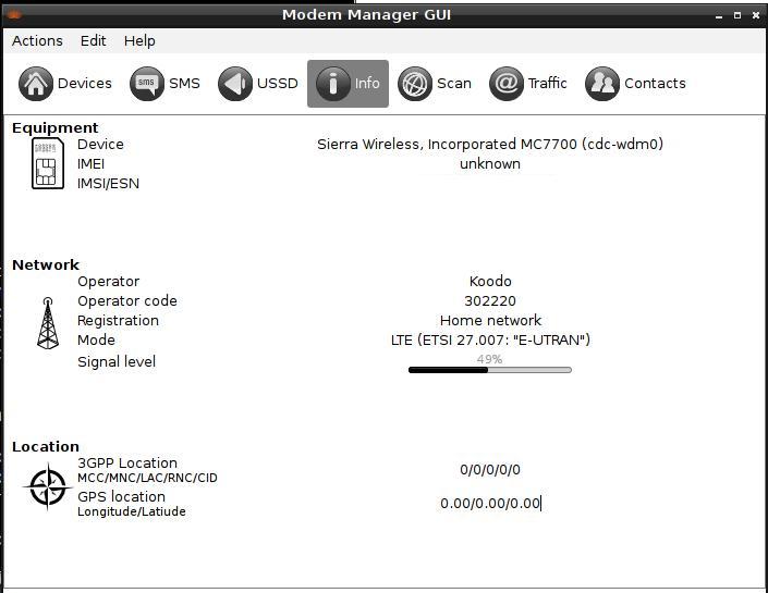

Finally received it. I installed it on Debian with QMI libraries and it easily worked with my Koodo(Telus) SIM. Surprisingly it would not work with my Videotron SIM.
But get this: I GET LTE ON A CF-19 MK2.
I'll find the time later to get it working on a CF-30.
EDIT: dip switches need to be off-on-on-off
- koodo-lte-cf19mk2.jpg (42.05 KiB) Viewed 15552 times

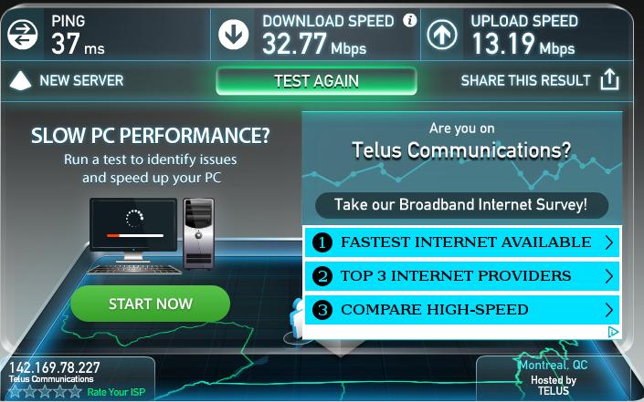

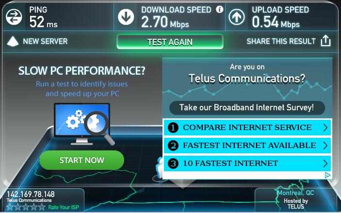

Speeds usually aren't good with my Huawei module and my indoors signal is weak. Here are screenshots of the speed difference between the MC7700 on LTE versus the Huawei EM820U on 3.5G AWS , both with the CF-30 and the Koodo SIM. Both indoors and sitting in the same spot.
Edit: images updated with tests using the same Telus server instead of the those suggested by speedtest.net which happened to be different for each connection. This makes the comparison more equitable.
- koodo-lte-cf30mk3-speedtest.jpg (66.55 KiB) Viewed 15544 times
- koodo-umts-cf30mk3-speedtest.jpg (66.33 KiB) Viewed 15544 times
