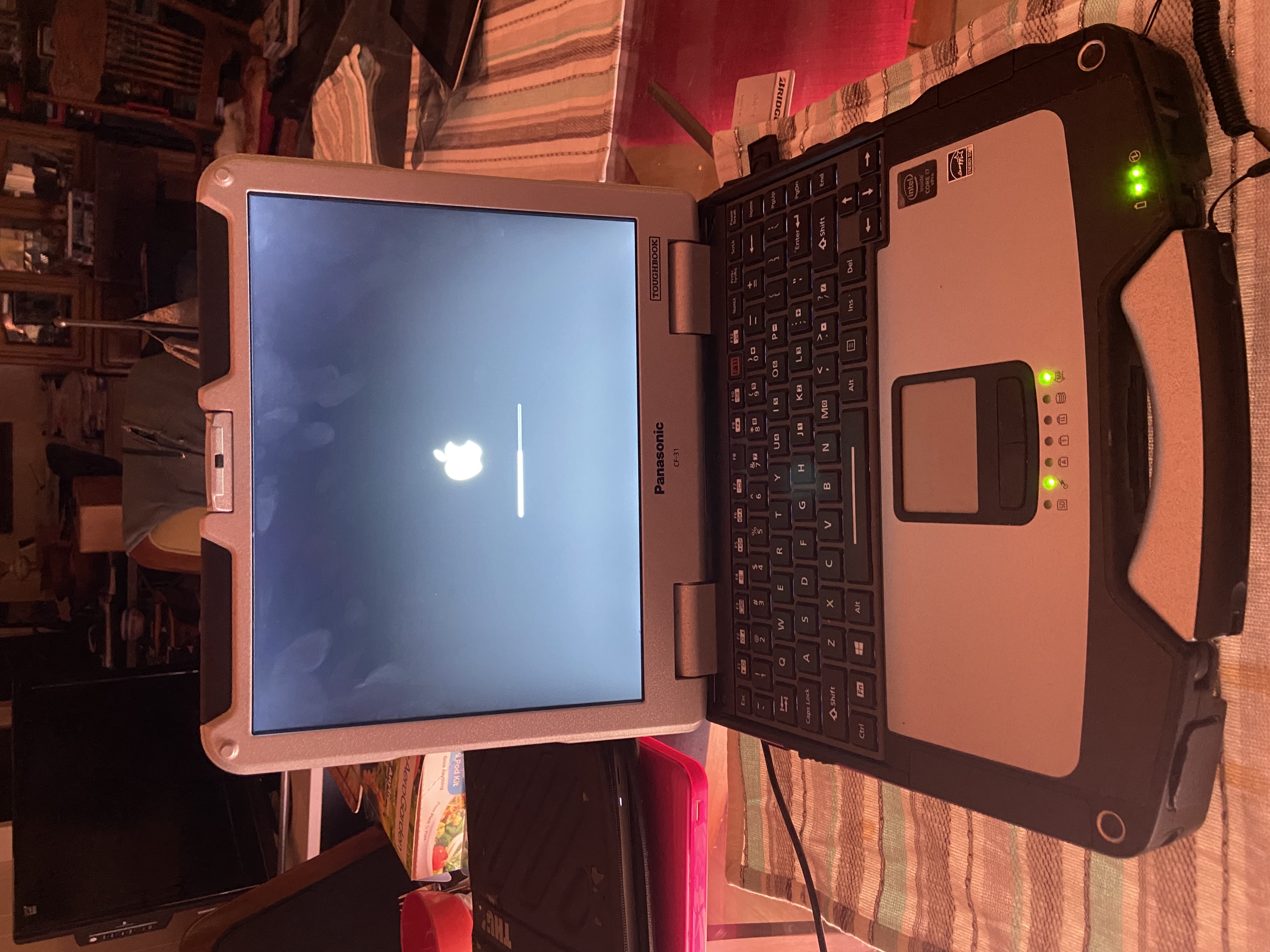

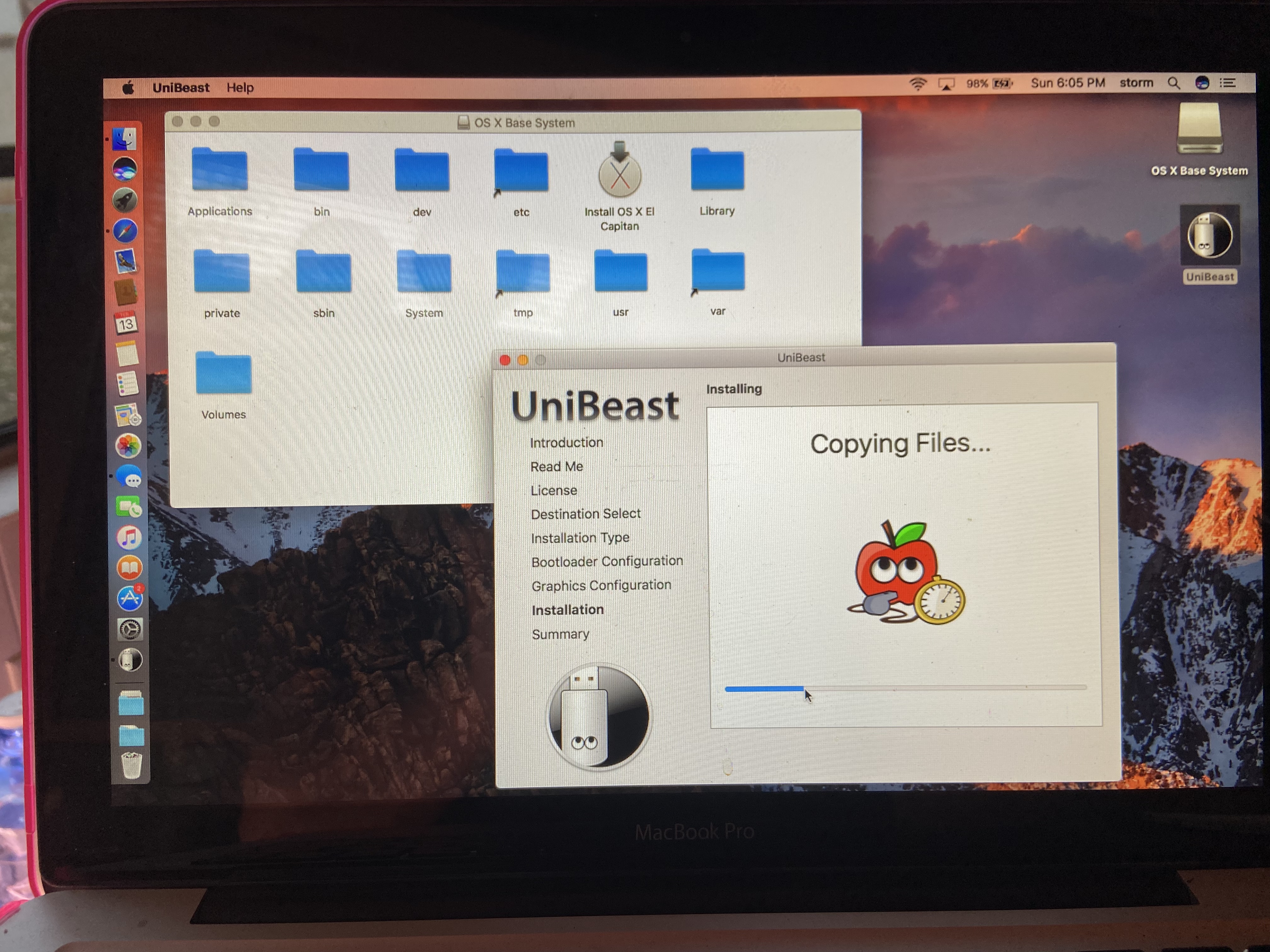

The tonymacx86 instructions are pretty good, but they leave out some kinda important details. Super simple. The Vice article goes much more in depth, but parts of it are very hard to follow. Between them, I got the installer made!
And partial success!
Unfortunately only partial as it then gives me the circle with a line through it and doesn’t fully load. I think it’s because the HDD isn’t properly prepped and needs a partition ready to take the installation. I think I will try again with a blank drive. I’ve actually had this same issue setting up the SSD for one of my Macs. OSX installers don't have any tools or means to prepare the drive. At least the Windows installers let you format the HDD.

Righty-o! So as normal, I have to pick the most complicated way to do things. I wanted OSX El Capitan on this Hackintosh as it comes by default with iTunes 11. I also have an older data backup for El Capitan, I think. I also should still have my music library backed up for iTunes 11. This creates another issue. compatibility across OSX platforms and drives.
This is a tricky thing to figure out... The compatibility list Apple actually posts, seem to be the least accurate. Like they say certain devices with specific versions can't do XYZ, but I have ones that can. Whatever, realizing their lists tend to encourage upgrades and possibly not reality, other lists aren't necessarily as well put together.
Here I am specifically interested in formatting compatibility. Apple's older Extended Journaled or HFS+ is better for mechanical or hybrid HDD. But Apples newer APFS+ is much better for SSD, and will considerably speed them up too over a HFS+ formate SSD. El Capitan though doesn't work on an APFS+ formatted drive. This might be the big difference between an iTunes 11 and iTunes 12 library too. When you install iTunes 12 is when I believe it does a long library conversion process.
The take away for now is to get iTunes 11, I need OSX El Capitan. For that I need an HFS+ formatted drive. I think I can actually mix drive types in an OSX system, but that's another rabbit hole... I know I want to upgrade to APFS+ for the SSD drive, but I think doing that also forces me to change to iTunes 12. Anyways the pain of trying to sort out what is what is putting me to sleep lol. I am going to format the CF-31 SSD drive here in a moment for the HFS+ and then probably just go to bed.
Okay my SSD is formatted for Mac OS Extended (journaled) with GUID Partition tables. I am going to go quickly stuff this in the CF-30 caddy and see if I get the installer to actually install...

Oh I didn't have any luck First time it gave me the progress bar for like 10 minutes, then the circle of nothing. I changed a setting in Clover, and it would give me the apple logo, then quickly go to the nothing circle. I lost the progress bar.
I got a weird thing in Bios/uefi where the only forced boot option is "clover EFI". I need to poke at it some more. I am also not sure if the tutorial applies to a laptop platform and desktop, or only the desktop...
I am probably at the point where I need to ask questions on the tonymacx86 forum...
