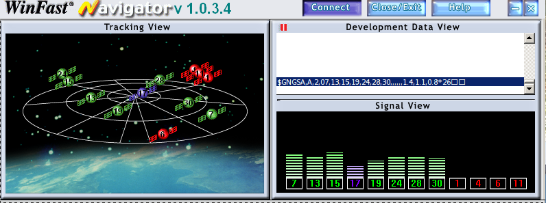

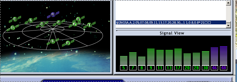

The results of five tested antennas. MC7700 in CF-53JULA21M. Linux Mint 17.2? .wine and Winfast Navigator.
Leads were attached to GPS connector (except #1)on 7700 card. Then antenna was taped to the lid.
1. With nothing attached to GPS connector........works kinda blah. It does work. This means with AUX and MAIN connected only.
2. Taoglas passive.............needs more testing.
3. CF-30 active............mediocre and slow.....ground plane needed?
4. DFUP1892ZA .......best of the lot.
5. DFUP1865ZA .......not to shabby.
I consider this pretty good performance (4 and 5). Definitely usable as a back up to embedded GPS.
I have one more to try but lost this post once already. There are comments near the photos/screenshots.
FWIW a bit OT but related to the thread title.
Here ya go.
- DFUP1865ZA STUFFED IN THE PLASTIC CASE.
- gpscase.JPG (5.17 KiB) Viewed 14878 times
- This was nearly as good as 1892. Shawn sent me the case.
- 1865ZA.jpg (5.32 KiB) Viewed 14878 times
- MC7700 + DFUP1892ZA
INSIDE AFTER IT FOUND ITSELF. - 1892inside.png (97.78 KiB) Viewed 14878 times
- gpsant1.png (78.91 KiB) Viewed 14878 times
