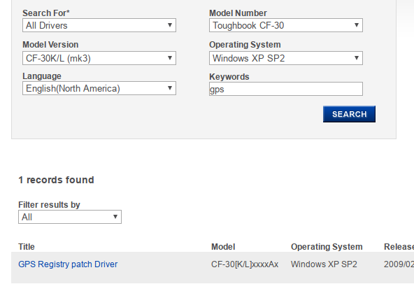

Wondering why is cool. Maybe this will shed a bit of light.
The CF-30 MK1 had no "switch" in the bios for tablet v.s. touch. So they did the switching with a different bios.
Windows 7 thinks it's a tablet. Vista thought IT was a tablet. XP ran as a Touchscreen and didn't worry about the fuss.
If your 30K is set on auto(touchscreen mode) or touchscreen in the bios it will work fine with XP.
Properly set up with Panasonic drivers your "working" XP will have a fujitsu component as the only resident of the h.i.d. section in [Device Manager].
Working W7 or Vista will show two generic hid drivers in [Device Manager] but not the fujitsu driver.
You should:
1. Run the install disk as a new install.
2. Boot to F2 and [F9][F10] "set to defaults" "save" after making sure touch is enabled. (Not tablet) You may have to reboot twice before auto mode works right. (semi-normal)

3. If you have a GPS on board disable it before installing. Then run this as Administrator.
- regpatch.png (27.96 KiB) Viewed 20599 times
